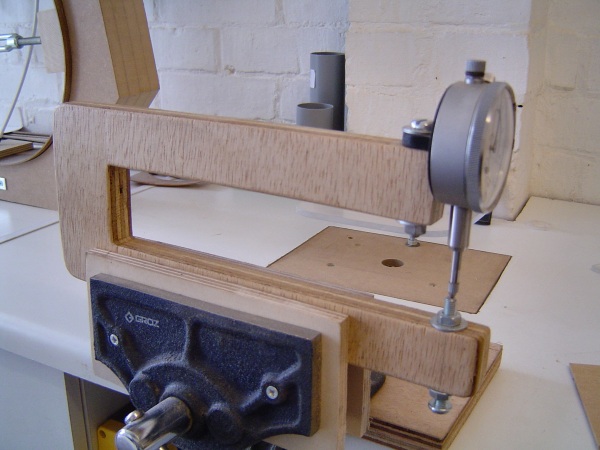

Well not being too bright I need your advice again. I have not been too happy with the side flex of my braced and carved top. Now I realize that the top thickness is not what I thought. Measurments were made with calipers but the ends measure .115 and .120 with the sides as much as .136. The back is similar but I'm not as worried because it would be easy to sand the back to make the best thickness. I guess I will build tool to test the thickness with my dial indicator to get a more accurate measurement. Question: Will there be a problem to thickness the top by sanding the top surface? My goal here would be to measure and sand until I get some side to side flex since it currently seems too stiff.

making a caliper using a $7.00 dial indicator and a scrap of ply is a good investment.

Once my tops are thicknesed I take caliper readings at close distances (every 100mm) and then mark same on the top with a pencil. I then photograph the top with markings so I have a permanent record of each tops thicknesses.

*If it were me, I would definitely make or buy some thickness calipers to measure the thickness of the top in several places that you can't reach with standard calipers, before gluing the top on. I'd want to know how thick it is in various places near the middle before I start thinning it further.

Phillip, you said this is your first guitar, so my advice would be make a thickness guage, doesn't have to be fancy a cheap dial indicator in a plywood body like this takes half an hour.
Then, thickness the whole top to the 0.115" dimension and leave it alone. You can leave the bit around the rosette alone if your worried about thinning it too much. Believe me most of the large manufacturers just run their tops through the sander and leave it at that. Don't try to overthink this one, learn from it.
